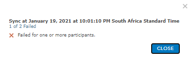

Our data is published to our Portal, and I have tried establishing a collaboration. It worked fine the first sync, but now fails every subsequent time with a message "1 out of 2 failed". Our Portal is 10.6.1 and is not public-facing due to security restrictions.

Inspect Portal for ArcGIS's logs to understand why your feature layer is failing to sync, I will assume you have the portal (guest) setup to send its feature layers as copies. Start by using the warning logs, there could be something obvious wrong.
Mondi_GIS
Good suggestion - nothing comes up as a warning, so upping the logging level to see if there are more clues.
Mondi_GIS
Nope - it all looks fine/successful on the logs, but I still get this error.

We had a similar issue and needed to configure our 10.6.1 Portal to use our corporate proxy https://enterprise.arcgis.com/en/portal/10.6/administer/windows/using-a-forward-proxy-server-with-po.... It's not public facing either but did allow us to setup Collaboration with ArcGIS Online.

We have tried the collaboration setup but it claims to sync but the updates don't actually show (The feature service shows an update and the map service does not?)
