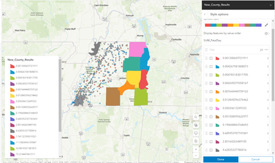

I am assigning symbology from a specific attribute. However, the map isn't not displaying the assigned polygon colors What could I be doing wrong?
RussRoberts
Esri Notable Contributor
Still looking at this but I think it might be some rounding taking place somewhere and then the types value could be off. I did a quick workaround map where I used an expression and set it to round to 18 decimal places which I think I counted in your data.

@RussRoberts thank you, I will work with the expression. I appreciate your help!
