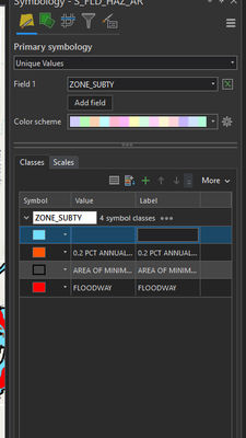

I downloaded data from FEMA and used the S_FLD_HAZ_AR layer. From there you can symbolize by the field ZONE_SUBTY. Within Pro it lets me move the blank 100 yr around in the symbology placement. Maybe try using this dataset? I couldn't get the one you provided to move around in Pro either.

I can symbolize just how I want in pro, but when I share it to AGO, the blank values (all of the 100-year floodplain) disappear and are left in the "other" category.  So the problem remains in ArcGIS Online with no seeming way around it.

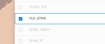

Unfortuinately I can't use the data straight from FEMA because we modify it slightly in certain areas.  I did notice that they use the two fields together for their symbology - I'm not exactly sure why, when just the subtype will do - but maybe that's just here and not the case across the entire US... Anyway, I've tried to do that as well and the Map Viewer doesn't allow the Zone_Subtype field as an additional field to use for symbology once the Fld_Zone field is selected.
