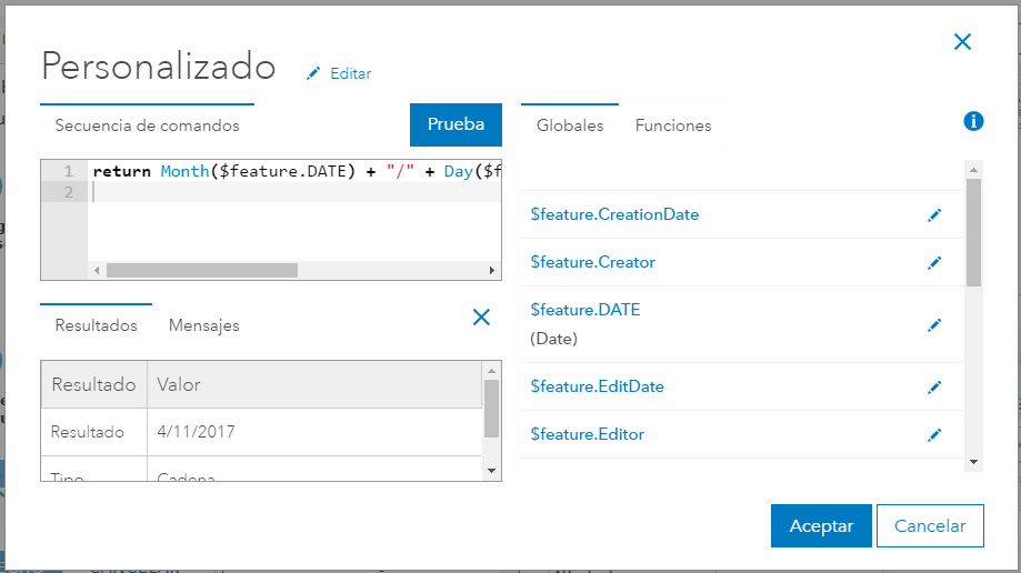

When select that option the Arcade expression window will pop-up and you can enter the following expression:
return Month($feature.DATE) + "/" + Day($feature.DATE) + "/" + Year($feature.DATE)
... and hit the test button to see if it works:
In this case it will extract the month, day and year from the date-time and create a string like the example "4/11/2017".

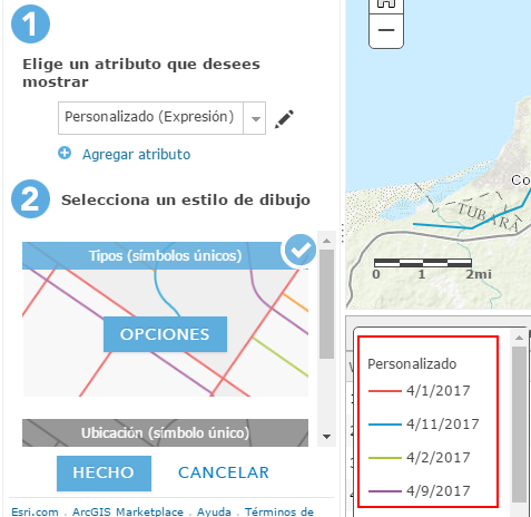

By default it will assign a different color for each date:
LaurenDibben
This did work. Thank you. However, I have no idea how I would find out what expression to have entered if you didn't tell me.
