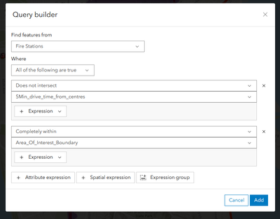

For your case, you would set the query as follows:
Find features from: Kelly's points, then click to add a Spatial expression.
Where All of the following are true
Does not intersect Drive-Time polygons AND
Completely within US Country boundary
It should look similar to:

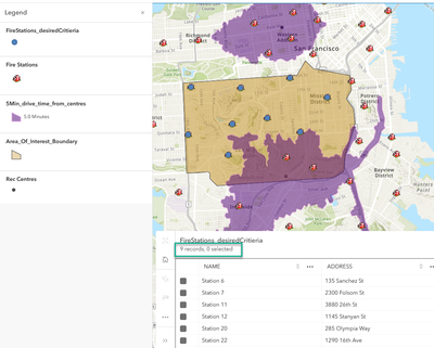

The result for this tool would be a point layer that is all the points that meet the criteria of being within the country border but not within the drive-time area (ex. points in blue below). Once you get that result, you could then simply look at the number of features as listed in the attribute table.

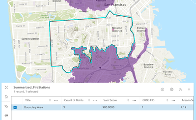

The result from step 2 will give you a polygon layer with the count of points within that area and any statistics you specify.

Again, the result from step 2 will give you a polygon layer with the count of points within that area and any statistics you specify.
