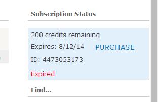

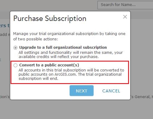

ChrisWhitmore
Hi Sven,
You can convert your expired trial to a public account, preserving both your web map and map tour. On the "My Organization" page, click the Purchase link. One of the options is to convert to a public account. Here's what you should see:
Here's documentation regarding the conversion from an expired trial subscription to a public account:
Manage trial subscription—Help | ArcGIS
