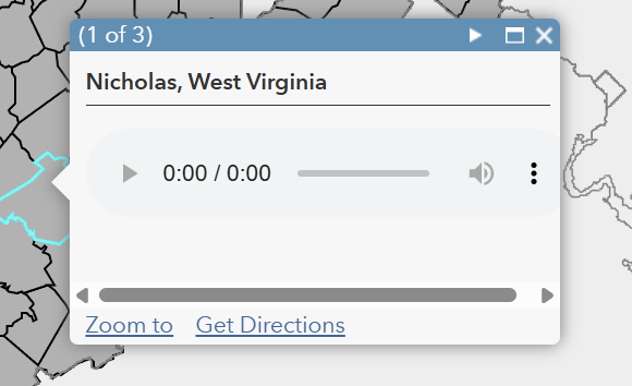

Hey y'all, I'm working with county data and trying to make it so that clicking on a county will bring up a pop-up with a soundfile unique to each county. There isn't a ton of information on this online that I've been able to fine, so I've mostly been going off of this discussion board to try and figure out what to do here. Pulling from a file directory on my computer hasn't worked, nor has using dropbox links.
Everything I've tried has just given me a pop-up showing a blank soundfile in a pop-up:

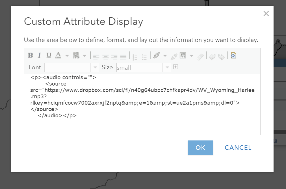

In the discussion board linked above, they're pulling soundfiles from a "downloads.esri.com" which I haven't been able to find any information on? Is there some way to upload soundfiles directly to Arc and pull from there instead of a third location like dropbox? Or is there something different I should be doing to make dropbox work?
Edit: solved! Just had to change the "dl = 0" at the end of the dropbox link to "dl = 1"
