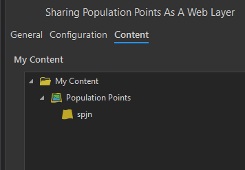

Also you might check the Content tab of the sharing panel. Does the sharing tool give you any warning about layers not being included when you click Analyze?

Thanks for the tip, but there is still nothing that warrants my layers not showing up.  I don't get any warnings and the content contains the layers that are not showing up.  All the content is from the same geodatabase. Now, my layers that do show up have the wrong symbols.  Any suggestions?

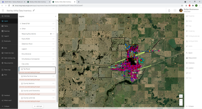

It's strange because all my symbols are there and not downgraded. However, they are all just re-arranged to the wrong layer.  This is a screenshot I took showing that the layers experienced an error in loading.  I think I'll have to contact support.

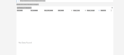

Just following up if there was a solution to this issue.  When I try to publish a web layer (28 layers) only about 7  show up with data in the hosted feature layer and the others show "no data found".  Tried all that was mentioned above and several other ways but cannot get the whole feature service to publish.  Any help would be great.

This happened a while ago, so I can't remember what I ended up doing to get it to work.  One tip I got from ESRI customer service was to remove associated tables in Pro and Online that don't need to be added.  Mine were weird geodatabase files that, once I removed them, the map worked fine.  Maybe that's your solution?
