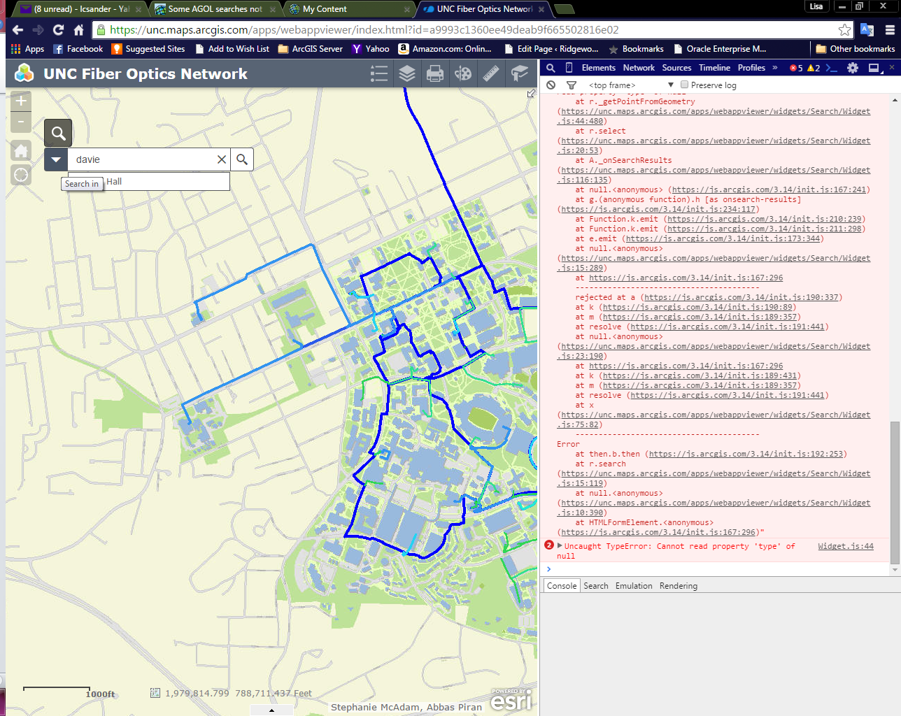

A screenshot:
The empty pop-up issue has been fixed. Could you give it a try and let's know if it works for you.
It's interesting. Now, when I search, I get a list of returned matches but when I click on one of the values in the list, it does not zoom to it or bring any pop up at all.
