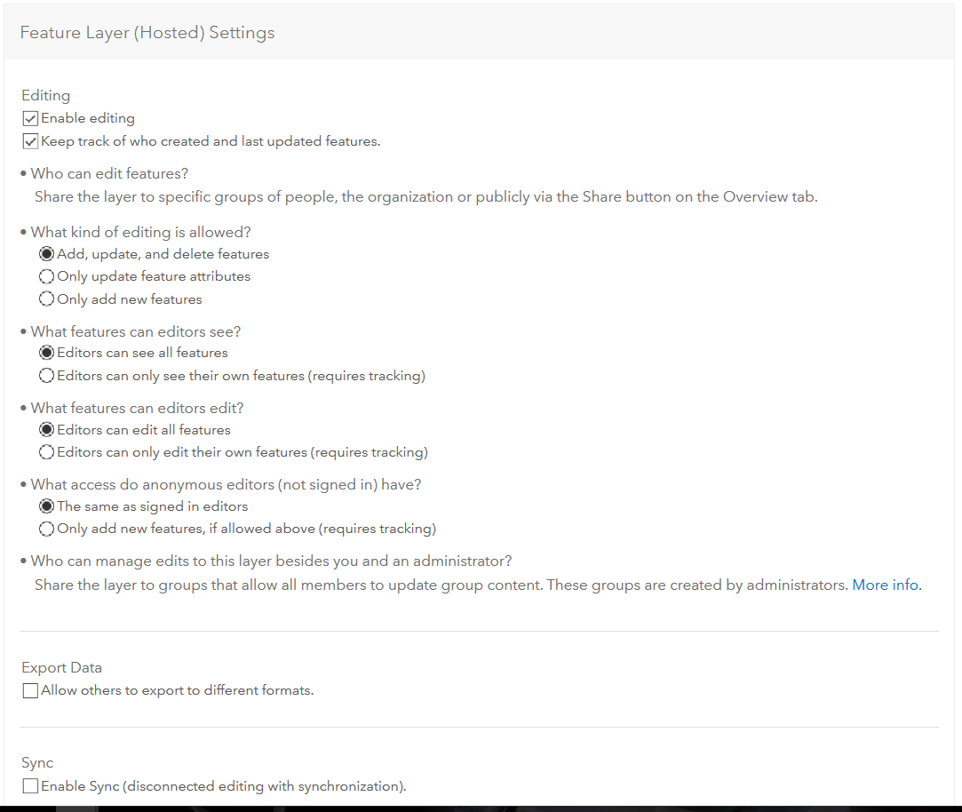

I feel like I must be missing something simple here. I have a simple web map with two layers. One of those is editable. However, when I click on the Edit button at the top
and edit the layer, the edits do not persist. I am the owner of the hosted feature layer being editing too. (I am eventually wanting to get another user to make edits to this layer but that isn't working either).
Do I need to do something different with my web map to do this? I primarily want to edit the Geometry of my points feature.
These are my edit settings:
Is it not possible to edit the geometry of a hosted feature layer in a web map?

I wish there was a way to allow editing of geometry but keep anonymous people away from adding new points. These are my edit settings:
It seems that I have to have "Add, update, and delete features" checked in order to edit the geometry, this allows any anonymous user to add new features (but they cannot update or delete these features with the checkbox of:
Or am I missing something here?

I don't think it is possible to limit anonymous users to just editing existing geometries - if you used the Edit widget in WAB, it allows you to 'Disable Update Geometry.' so users can't move or add points but they can just change the attributes: Edit Widget
Maybe you could use a filter to limit what is displayed? For example, have a field called Visibile and the default set to No (you could set up a domain for yes/no from Pro/ArcMap or through the rest end point). In the web map, set a filter so that points are only visible if Visible = Yes and disable editing of this field. Then if an anonymous user tries to add a new point, it will appear but then disappear because of the filter. This means they can only see and move existing points. This will mean a little bit of work on your side to delete points added by anonymous users but it might be a potential work around.
