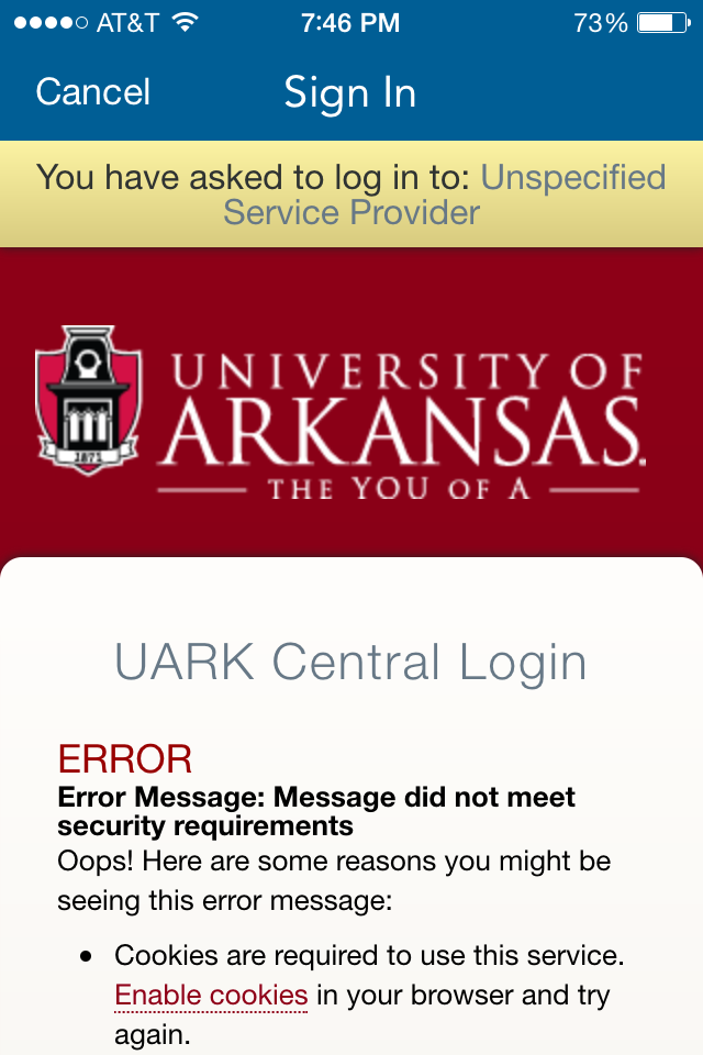

BrianCulpepper
Russ,
The message we get says:  You have asked to log in to: Unspecified Service Provider
Our enterprise logins work from a desktop web browser, so we only see this error message when
we attempt to log in from the ArcGIS Collector app (iOS 8.0.2).   we've not attempted connections
from Android or other iOS versions yet.
Our security team initially thought the issue was related to Collector not redirecting to an https://
url when prompting for our university credentials.  Any ideas?
thank you Russ!!
best,
brian culpepper

FrankPotempa
We discovered our issue with external access by the following tests;
-use internal wifi, not public or cellular network, with iOS devices and laptops to confirm devices can connect on internal network. Login through browser to AGOL org site on both, then try Collector .
-Then use external wifi, public or cellular network, with iOS devices and laptops to confirm devices can connect on external network.
Review any and all possible logs and security settings in reverse proxy, if applicable, and other web servers in configuration. In  the end we discovered that access was only working inside and the only way to tell this was to connect the iOS device to the internal wifi which it then worked.
