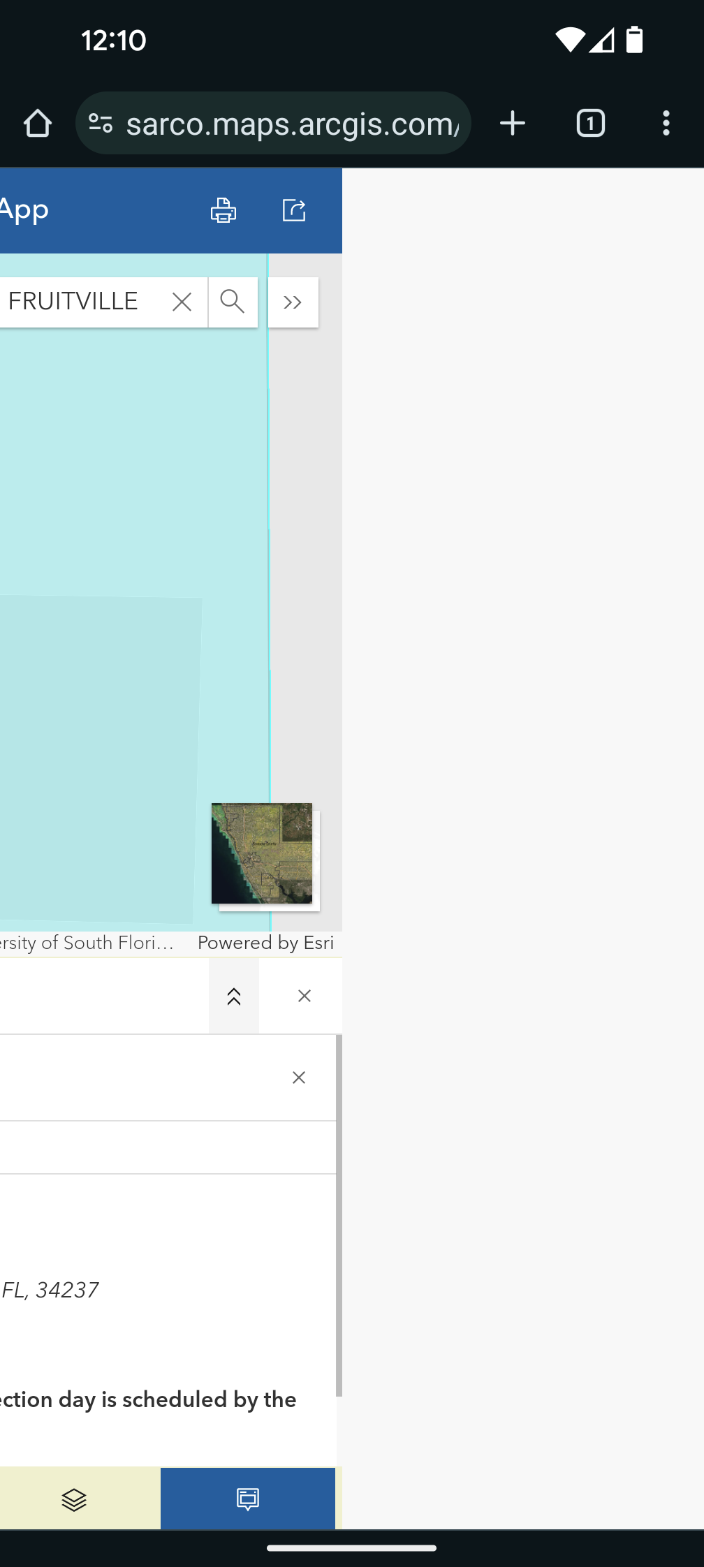

Hello - For the Sidebar Instant App, I discovered that any new sidebar apps created since the February update have a display issue on the Android 14 OS, In my case a Pixel 8 Pro with the April 5, 2024 security update.
When interacting with the search>map layer>popup, the return 'cuts' the display in half on the device:
When just interacting with the Map only> tap:
Sidebar apps built before the February update have no issue with either map tap>popup or search>map layer>popup:

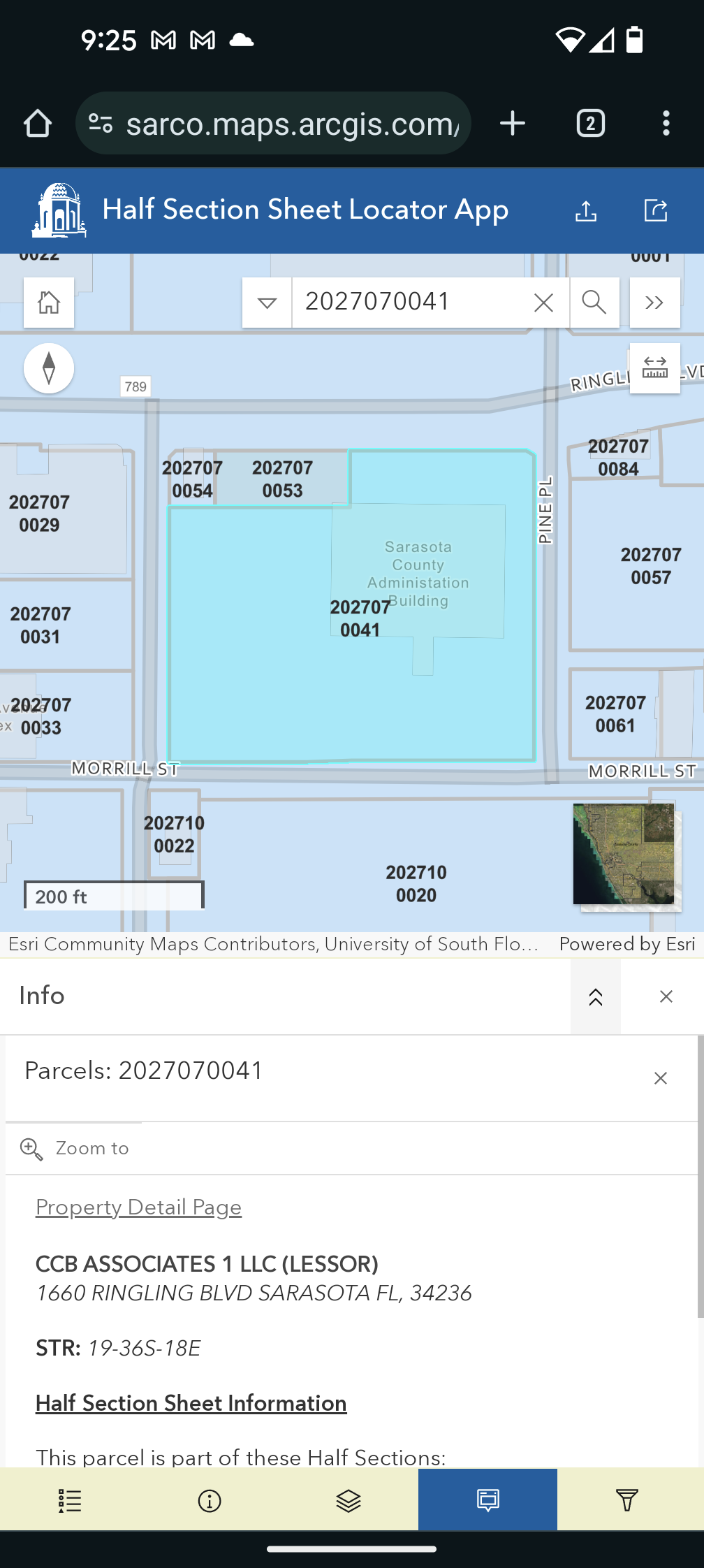

Here is a link to an app where I do not encounter the issue - a ''half section locator' designed to help the survey community find 'half-section survey sheets by entering a parcel id and return info based on the 'half section' layer in the map by Arcade Intersect. If you begin to enter one of our parcel ids 2027070041 you can see.
https://sarco.maps.arcgis.com/apps/instant/sidebar/index.html?appid=d55aec4f12fa4b4187065af4e43568ad

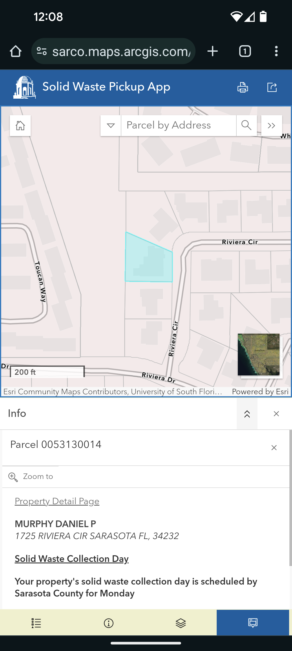

Then I have Solid waste pickup day app that basically does the same thing - returns your solid waste pickup day based on a Solid Waste Zone layer in the map.  Here you can enter an address 1001 Sarasota Center Blvd and the search will find it on the fully-indexed 'full address' attribute in the parcel layer.
https://sarco.maps.arcgis.com/apps/instant/sidebar/index.html?appid=d64ce89561a64f92be884ff8bbc6eb1f
This is an app I stood up on Friday and does exhibit the behavior.
Both apps work just fine when interacting with map taps.  It just seems to be related to the search interaction, when returning the info by search.  Both apps behave as expected on the desktop....
