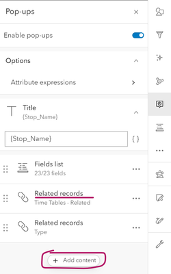

When configuring your popup, you can add your related table attributes as follows - click +Add Content then Related Records and select your related table.
While the above is the simplest method, it will require your users to click into the related records from the popup. To eliminate this step and pull the related attributes directly into the popup, you can use Arcade scripting by adding an Attribute Expression then create a FeatureSet containing the attributes and their groupings. The following blog walks through an example.
