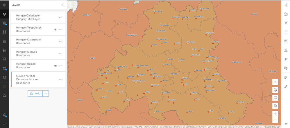

Hi Jozsef!
I searched for a number of layers having to do with Hungary on ArcGIS Online and got this far:
If you click on the layer on the left (blue line) and the click on filter (funnel on right side) you can select what you want. If You click on the label tag, then you can label the name, and choose font, size, color and placement. If you click on Symbology (circle square triangle) you can choose the background color of your polygon.
I couldn't find Jara, so you still have some hunting to do. Are you in a class right now and is this your homework assignment? Let us know how you're doing.

Hi Jozsef!

RonaldHaug
MVP Alum
Hi Josef,
I think you're asking two things.
1) How to save filtered feature layer like cities in Heve.
Click the 3 dots in the layer and then click on Save as:
2) Save, Share and Print Map.
That you can do on the left hand side.
ArcGIS Online is different than ArcGIS Pro. I used to call it ArcGIS "Light", but it's actually quite powerful once you figure out what buttons to push and where your data goes. I am currently taking an online class at Esri called a Mooc ( Massive Open Online Course) in Spatial Analysis using ArcGIS Online. Check out esri training for more info. https://www.esri.com/training/catalog/search/
