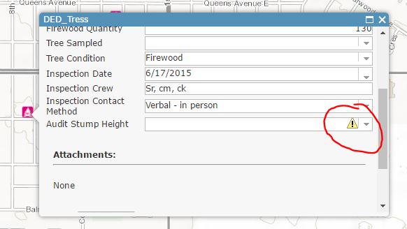

I've been trying to use the new Smart Editor widget to edit certain fields of a feature service,however, it's preventing me from saving these edits because, as far as I can tell, a 'required' field in the service must also be edited.  As Josh White inquired in his original post, I'm also unclear how this field got flagged as being required (see image). More importantly, how can I remove this field requirement?  Re-publishing the service is not an option as field crews are actively editing the data using Collector.  I've tried editing the feature service URL by changing the field property from  "nullable" : true to "nullable: false; however, this is not persisting after I update the layer definition. Any ideas on how to get rid of this feature service field requirement would be appreciated.
TonyViveiros1
I meant to say I've tried editing the feature service URL by changing the field property from  "nullable" : false to "nullable: true...
