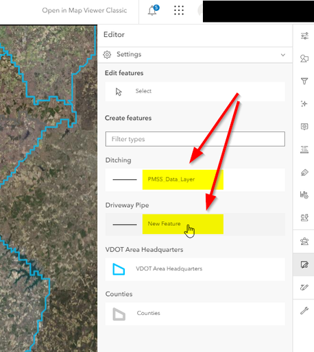

I am trying to figure out is this value can be changed (See image below).  I have a user that created a couple Hosted Feature Layers in AGOL and then created this web map.  It does not appear that there is a Editing Template created for these layers but for some reason I cannot change the text of the highlighted nor figure out where it grabbed this text from....
Was this set from the initial build of the Hosted Feature Layers Name?
Noting that I can change the "Ditching" and "Driveway Pipe" text with no issues but not the sub text to that Feature Layer.
Any thoughts?

Looks like a feature class with subtypes was uploaded.

You can modify editing templates in the Classic Map Viewer but not the new Map Viewer.
Kind of clunky but try adding the layer to a Classic Map Viewer map, click Edit and then Manage at the bottom of the Add Features panel.  You can change the name of the template in there.
Create feature templates in Map Viewer Classic
Does that help?
