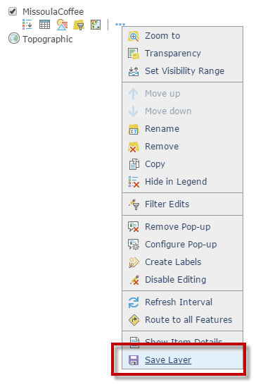

Hey Mark,
You can in fact save the pop-up configuration (and style) for any hosted feature layer.  Once you configure the pop-up for a layer in a web map simply click the More Options button in the Contents section for that particular layer and select Save Layer.  Next time you add this layer to a new map the pop-up configuration will be the same.

KyleBalke__GISP
Hey Mark,
MarkYoung3
Hi Kyle,
Thats what I was looking for - thank you.
