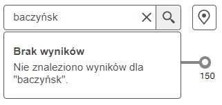

for a few weeks i have a problem in my application that was made in Web AppBuilder. While searching adresses in "near me" widget it recquires the exact name of the adress. Earlier, it was possible to enter only a part of street and a lot of examples were shown. Right now, I have to  enter all the letters from the street segment instead of this main segment that is, for example, the name of the street patron. I know there is an option to turn on/off "exact match" but its not working. there is no difference whether its on or off.
Maybe it's the fault of some AGOL update...

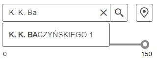

It is like that:
Earlier it was possisble to find that adress by entering only this: (it says "no results")DominikaBujanowicz_2-1669881581406.png

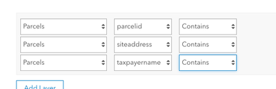

So...this is a pretty big change, if I configure a field in the map viewer like this:
you've effectively changed the meaning of "Contains" it no longer means "Contains" and is in fact more of a "starts with" query. We now have now way to search for tax payer names by last name in this situation.

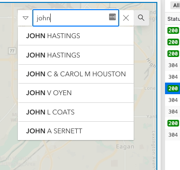

It looks like this same issue now happens in dashboards as a result of the update:
For example, typing "John" into a parcel owner field gives results:
But typing "Hast" gives nothing because of the missing wildcard:
where(LOWER(own_name) LIKE 'hast%')
