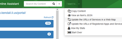

For the find-and-replace process, you really just need the AGO Assistant.

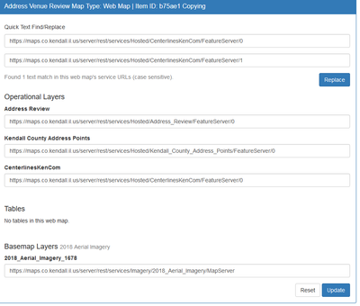

Once you're connected to your portal, you can select Update the URLs of Services in a Web Map and you'll see the following interface once you've clicked on a map:
Notice that with the URL entered in Find, I see a little notice that one of the layers in the selected map matches the service URL. Clicking Replace and Update is all you need to do.
Coupled together with @DavidPike's script for finding the maps in question, you could easily go through and replace all the layers.

A couple of quick notes though - I've just test the ArcGIS Online Assistant to try the find/replace function and whilst the URL was indeed replaced, the layer information wasn't. When you look at it in the map, the name is the old name and the page opened when you click on the item properties is the old items page. It really is just a replacement of the underlying URL but nothing else.
