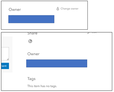

I can remove them from the group, but it looks like any content they contributed (probably shared to the group, I think) doesn't provide ownership settings. It looks like this on comparison (sorry, I have to block out names!):
The top user is from our org, while the bottom user is from an outside org.
The general issue is they I think they created a bunch of materials for a faculty project, so I think if I remove the user - would it potentially remove those materials from the group if I can't transfer ownership? For example: there is an app owned by the outside user that is shared to the group, so I'm not sure if I remove the user, if it will remove the app.
For all the other members in the group, I'm able to fully control their content, permissions, etc. It's only the outside org member that I can't manage their content shared to the group.

This is correct. The external user would own the content they created. You can't manage the items of users not in your organization. Removing them from that group would also remove the content they have shared.
It is difficult to copy content between ArcGIS Online organizations. This would also require the external user to assist with the process.
You have two options:
  • Leave the external user in the group. Remove content from that group that you do not want the user to access (and share it through internal groups). This would allow you to continue to use the content that user has shared. But also prone to losing the content if the external user modfies/deletes/unshares it.
  • Try to replicate the content the user has created with the goal of removing the user from the group. Some content is easier e.g. 'save map as'. Others less so.
Which option is best depends a lot on the content. Personally I would prefer not to have reliance on content owned external to my organization, unless it was a reliable government source etc.
The external user should not be taking up any licences as these should only be able to be assigned to users in your organization.
What the user can 'edit' largely depends on what content is shared to the group. They will be able to edit features on Hosted Feature Layers with editing enabled to the group. They will also have full control over the maps/apps they own e.g. if they made a map using one of your layers, you own the layer, but they own/edit the map.
