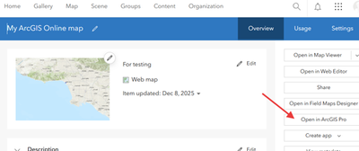

For part 1 of your question: How are you opening the map?
You could try
  • refreshing the map in Pro.
  • opening the map from the map item details pageEmilyGeo_0-1765225200877.png

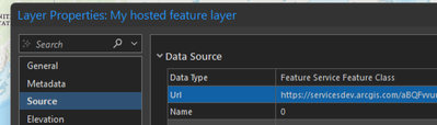

Are you working with a hosted feature layer? If so, any edits you make in Pro will automatically save to the layer.
JB82
when I clicked open in arc gis pro it gave me a download so I don't think so
EmilyGeo
Hi @JB82
To see a layer's source in ArcGIS Pro, double click the layer in the Contents pane to open the Properties, then go to the Source tab; this will show you the data type, location (path or URL), and more.
If you're working with a hosted feature layer, you'll see the URL. You can use that to add the layer to a map in either ArcGIS Pro or Map Viewer. This learn lesson is a good resource with tips for setting yourself up for successful editing in ArcGIS Online https://learn.arcgis.com/en/projects/create-forms-and-templates-for-editing/
