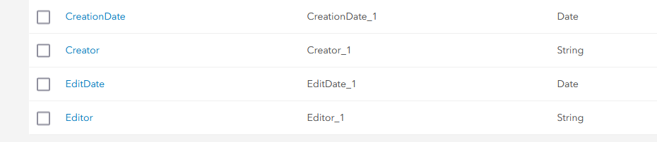

Hi all, I have a feature service that once upon a time I had enabled editor tracking. Each feature does indeed have a creator, editor, and timestamp, but at some point I must have turned the tracking off. I'm looking to re-enable tracking, but when I do this, instead of using the existing fields for Creator, CreationDate, etc. it added fields of Creator_1 and CreatonDate_1 and so on, populating them with the current time and my username. This is undesired -- I'd really just like it to keep the existing fields (and their values) and overwrite them next time they are changed. As owner of the data, is there an easy way to do this?

I went to the feature layer's settings in AGO and turned it on.
Clubdebambos
MVP Regular Contributor
I thought so alright. When I do this it works perfectly fine and re-instates the Editor Tracking fields. Long shot, but you can try the script below to see if you can update the JSON definition. Update the name of your fields in the dictionary if necessary, add in you feature service id, and point to the correct layer. Im not sure if all entries in the JSON can be updated this way. But at least you can rule out this approach. If it works you can then delete the newly created fields.

The previous suggestion involving editing the JSON may work but I have not tried it.
RhettZufelt
MVP Notable Contributor
Unfortunatly, this seems to be a field that ESRI doesn't allow editing...
Both the update definition in the REST, and the script reports 'Success', but no changes made.
R_
RebeccaLoiselle
There is a geoprocessing tool called Enable Editor Tracking which allows you to specify the fields you prefer to use.
