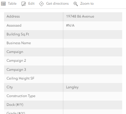

Hi,
I am wondering if there's way to re-arrange the order of my table rows (records)?
For example, I want to see the City before Business Name, is there a way to do it?
RussRoberts
Esri Notable Contributor
You can do this when you edit the popup in Map Viewer.  You can check out this article
https://support.esri.com/en-us/knowledge-base/how-to-rearrange-and-remove-fields-from-pop-ups-in-arc...
