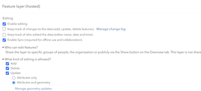

@JonahCrooks It sounds like you have sync enabled on your dataset. Can you check if that is the case? If so, then yes only adding features is supported because appending data into existing features that are syncing may cause data loss. Hopefully that helps 😁

May be reading through the following may help
Updating data in ArcGIS Online just got a whole lot easier
Also, may be under Layer > Settings in AGOL check the following
