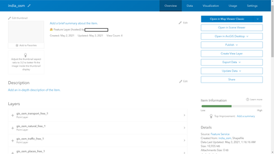

I can't view the item details (see below) could this mean that something went wrong during the upload? the gdb size is almost 20 GB.

I tried uploading zipped shapefiles of 1.8 GB, followed by creation of hosted feature services. Upload executed fast, but creation of hosted feature layer took around 3 hours. The size of the hosted Feature Layer was around 11 GB then.
You can upload files up to 500 GB to My Content through a web browser. Considering the increase in size of the hosted feature layer multi-folds, I will not recommend the process of uploading such large datasets to AGOL.
Publishing file geodatabase contents is a useful workflow if the geodatabase contains only a few datasets.
Rather, you should design the layers (symbology, visibility scale range, etc.) in ArcGIS Pro, and publish the hosted features from ArcGIS Pro.
