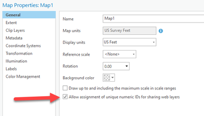

Did you remember to enable the "Allow assignment of unique numeric IDs for sharing we layers" first?
If not, and anything changed, the layers could all have new id's, and existing maps will try to load this by the id.  If not the same, can get the No Data Found errors.

Thank you for the suggestion.  Yes, the "Allow assignment of unique numeric IDs" option was checked, and all the layer IDs remained the same.

  7. Change the map settings to allow assignment of unique IDs
