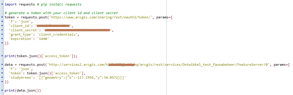

     I cán use a client_id/client_secret I got after registering at developers.arcgis.com to access a hosted feature layer that is shared with everybody: (code from developers.arcgis.com, sorry didn't find a code tag)

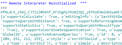

the response is first the token and second a lot of data:
When I  try the same with a hosted feature layer that is only shared with a group local to my agol I get a neat response as well:
As expected this id/secret does not have permissions to that feature layer. So far, so good!
