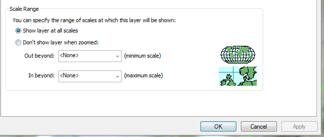

At what scale are you trying to view the map at?
CityofWestPlains
Set for all scales. I attached a picture of where I’m having the issue.
CityofWestPlains
It is set on show layer at all scales
