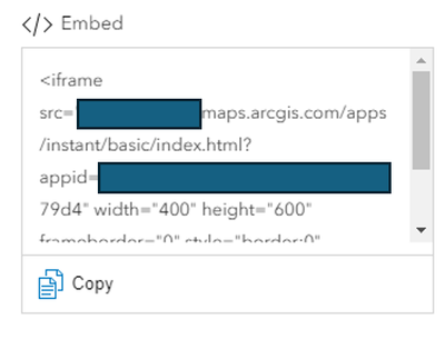

As a side note if you want to use a web map with Map Viewer configuration like popup elements,  vector symbols, label classes and more - I would recommend using an Instant App and that will give you the embed snippet similar to Map Viewer Classic.
