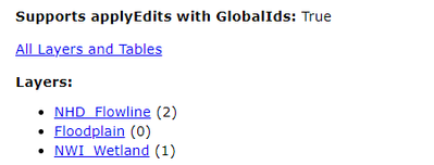

For example, this service has three layers
In the rest end point details page, their layer ids are seen to be not top-down-sequential

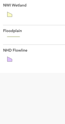

The resulting view has the layers in a different order, which would not be terrible, except...
When opened in the map viewer, everything falls apart. This is the third ordering scheme, and floodplain is a line layer, and the flowline layer is a polygon. Creating the view manually does not have this effect. It works fine, but is laborious. There are many filters that need to be applied.

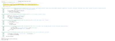

It appears that the attribute 'preserve_layer_id' is what you need when your ids are non-sequential, but I have not had luck with that:
This code:
new_view=flc.manager.create_view(name=serviceName+"_View5", preserve_layer_ids=True)
Gives the following error:
If I change True to False, I get no error, so I don't think the problem is that I'm entering it wrong. It just refuses to accept the value of True. Does anyone know why? Creating the view manually preserves layer ids by default, but programmatically creating views that are useable even if the ids are out order would be very helpful. It's not always apparent that this has happened until too late.
Thank you for any help you may be able to provide.
