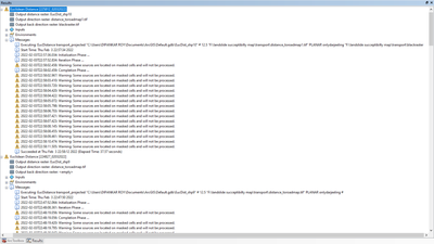

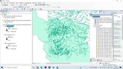

every time i want to process Euclidean distance operation in Arc Gis ..i came up with an error message ...can anyone help me ...

they are warnings, what was the error message?
Was any output created?

yes it created an output file ...
still, i getting this error message

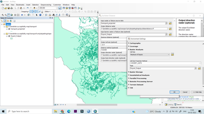

yes, I have converted all my data into a proper projected coordinate system...WGS 1984 UTM 45N zone in my case
My F drive is a Local drive, not USB stick

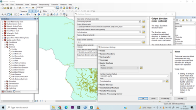

it is a warning, not an error, some of you locations are on masked cells and they won't be processed.
I don't know where those locations are but they are excluded from being processed, you will have to remove the "mask" or exclusion area
