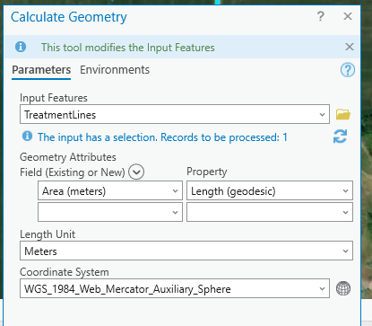

I need help to try and understand why the Arcade Geometry function for, in this example, length in meters is so off?
I created a feature that I knew was about 0.5 mile (~804.6 meters) - I also calculated it out in Google Maps. I have a field in my data where I use the calculate geometry. Calculate geometry in pro comes out to 812.06
but when I use an Arcade expression Length($feature, 'meters') to automatically calculate the length... it comes back as 1,104.07!
Can someone please explain to me what is going on? This is happening with all of our line and polygon features. I will probably remove the arcade expression because it is providing our users with completely inaccurate numbers.
AlfredBaldenweck
MVP Frequent Contributor
In your pictures, your calculate geometry is using the Geodesic Length, but your Arcade is using planar length.
Perhaps try LengthGeodetic() instead?
luckachi
Thank you @AlfredBaldenweck ! That corrected the mis-match.
