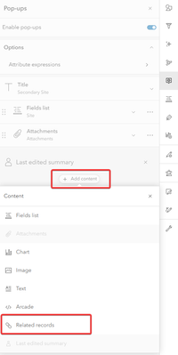

Wanting to understand if there is a way to publish a dataset and it's related tables from Pro preconfigured so that it does not need to be configured anymore in the web map. Would like to have to set it up once in Pro and then not have to touch it in ArcGIS Online.

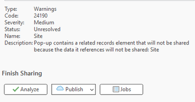

Whatever method I try to use to publish from Pro, I can't fix the error message below, details at the link below don't help either.
https://pro.arcgis.com/en/pro-app/latest/help/sharing/analyzer-warning-messages/24190-pop-up-contain...
Currently, if we want the users to be able to see the related records in the webmap, we have to go into the web map and configure it as per the screenshot below.
For Field Maps, this is not an issue and the configuration from Pro works.

This message appears and as far as i can tell the popups are configured correctly and the table is in the map. The related table still comes through when publishing but the problem i have is that it needs to be configured for every AGOL web map instead of the configuration passing through from Pro.
There is also no spot on the visualisation tab on the web service to set it up.

Correct, the documentation above says you need to configure it on the map in agol and use related records element records as it dos not support an in map relate.
Pretty sure it is expected behavior to set enable related records in the popup of every map, since all popups can be customized.
