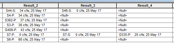

We have a hosted feature layer that published from a feature class in a file geodatabase.  The attributes in the columns are formatted in a specific desired way so as to have padded spaces between characters in these TEXT columns.  As seen in the attribute table itself:

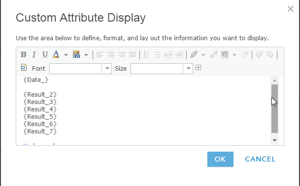

For the feature layer after it is uploaded and a hosted feature layer is created, we set a custom attribute display and configure the columns as required:
