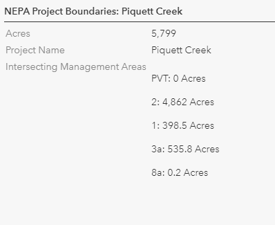

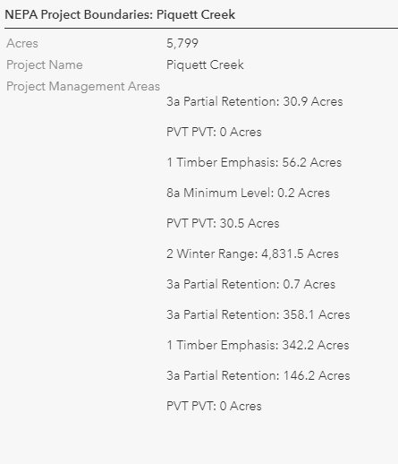

I am trying to add calculations for areas that intersect a project boundary, but have run into an issue with single part polygons returning an area for each intersecting polygon.  I ran a test with a new layer with the polygons dissolved to multi part polygons and I get the results I want, but I need to be able to group the data from single part polygons as its not possible to edit some of the layers I need to run this on.  I've included the Arcade code below that I've used, along with screen captures of the results on the single and multi part polygons.
I did some searching and found the GroupBy function, but cant figure out how to set that up it will even do what I want.

Thanks Josh,
I've been trying to get the GroupBy to work and I think I'm close but there is still an issue with the calculated area.  With the code below I'm getting for the popup.  But the acres calculation is not accurate as its not adding up to the total acres in the project area.  I pulled up the Shape_Area field and did an Arcade AreaGeodetic calculation on the project boundary to confirm, but can't figure out what the issue is.  Our data is in a UTM projection which does explain the Shape_Area to Acres seen below, but if I use the square meters to acres conversion of 4,046.856 the calculation is still off.  PVT should be about 30.7 acres
Shape_Area / 43560 = DavidHood2_0-1614815331408.png
Shape_Area / 4046.856 = DavidHood2_1-1614816099828.png
