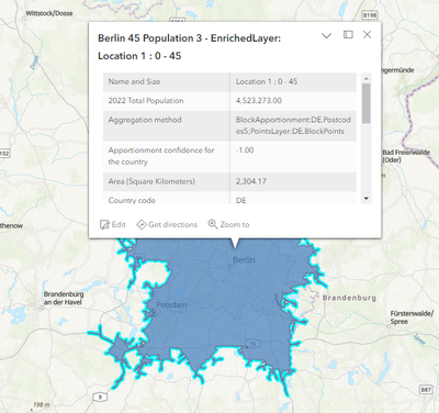

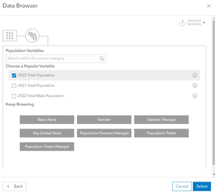

Hi @Finn, here's a solution I found. First, I created a 45 minute drive-time for Berlin. Next, I used the 'Enrich Layer' tool in the Map Viewer, selected 'Germany' and 'Population':
Then, I selected '2022 Total Population' and ran the tool.
This tool will create a new layer with the estimated population as an attribute:
You'd be able to achieve something similar for any area, using country specific population data, or the global population data.
Hope this helps!

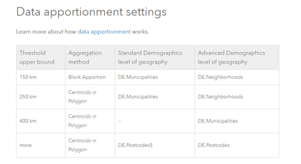

thank you very much for your instructions. This is exactly what I was looking for. This function is great. Maybe you can answer my question as to whether the population figures of the federal states or NUTS3 level are simply applied proportionately to the 45-minute area or whether it is only applied to the communities and cities that are actually located in the area.
In your picture, Potsdam, for example, is just about in the area. This leads to the question of whether the population figures are taken proportionately from the whole of Brandenburg, or whether the actual people in the area are taken into account.

Hi @Finn,
I'm hoping this documentation answers your follow up question: Germany—Esri Demographics Regional Data | Documentation (arcgis.com)
Some more information on Data Apportionment: https://developers.arcgis.com/rest/geoenrichment/api-reference/data-apportionment.htm

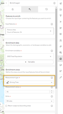

AmandaRing
Esri Contributor
@Finn for future reference, you can actually also create the drive-time radius from within the Enrich Layer tool itself, as long as your input features are points.
If you wanted the result to still be your initial point feature, just with the extra enrichment data, you would leave the 'Return output as bounding areas' parameter unchecked. If you wanted the result to be the drive-time polygon, you would check the box for 'Return output as bounding areas'.
