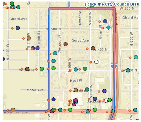

The problem is that the point is not being displayed in the proper location. As you say, if you click to the left of the point, you can get the popup. This is actually where the point should be displaying, but it's not. The problem is with ArcGIS Server. Because you are accessing an image service on ArcGIS Server, ArcGIS Online sends a request to the server to get the image. Here's the request that gets sent:
http://maps.slcgov.com/mapservice/rest/services/police/crimeStatistics/MapServer/export?dpi=96&trans...

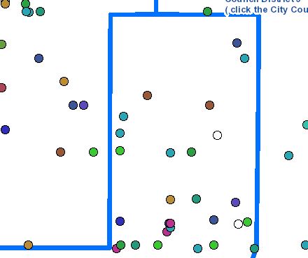

If you click this link, you'll get this image back:
I added the same layer a different way in ArcGIS Online, on top of your original. Notice that the orange point (the ones I added) are shifted left. Strangely, the polygon outlines are not shifted, so this seems to be a problem specific to point layers. The reason you were able to get the popup to display when zoomed out is because of the scale difference. At smaller scales, the point falls within the popup search tolerance to find it.

  1. It appears that you work for the city, and thus might have some control over ArcGIS Server. You can upgrade your server and see if that fixes the problem. This is a pretty specific problem, so I'm not sure if anyone has noticed before. I believe it has to do with transforming the data from EPSG: 32043 to EPSG: 3857. The only way to know for sure would be to test it out.
  2. You could republish your data in EPSG: 3857. This would mean ArcGIS Server wouldn't have to transform the data to display in ArcGIS Online. However, you may still encounter the same problem, because your data would have to be transformed into that spatial reference by ArcMap (by setting the coordinate system on the data frame) when publishing to ArcGIS Server. But you would know immediately by just setting the coordinate system in ArcMap, I believe.
  3. You can add the layer like I did above, by directly targeting the sub-layer in the map service. Add it to the map as a layer on the web using this URL: Layer: Crimes in the past 10 days (ID: 0)‌. One limitation with this approach is that there are too many points to display when zoomed out fully, and you'll need to set scale dependencies on the layer so that the points don't display when zoomed out. Drawing the layer in this manner bypasses the image generation of the server and instead requests the actual geometry of the points. The browser then draws these points as graphics. The limitation is due to the fact that the browser can only draw so many graphics, thus you have to set scale visibility appropriately. Also different browsers have different abilities in terms of how many graphics they can draw.
