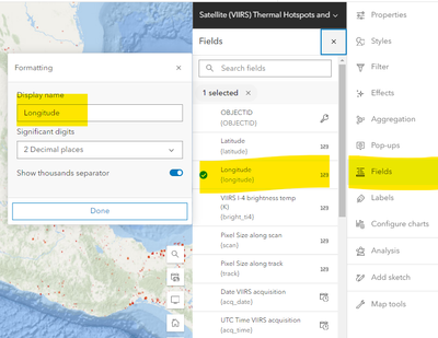

Are you using Map Viewer to configure the web map?
If so, you can use the Fields pane to set the Display name for each of your Fields. Is this the workflow you are using?

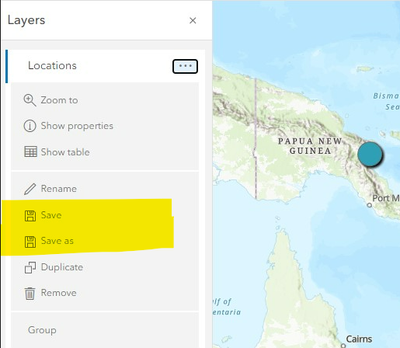

EmilyGeo
Hi @KTA  In that case, one option is to configure the layer how you would like it to appear in one map (symbols, pop-ups, display names), and then Save the Layer. That way when you add it to additional maps it preserves those properties.
