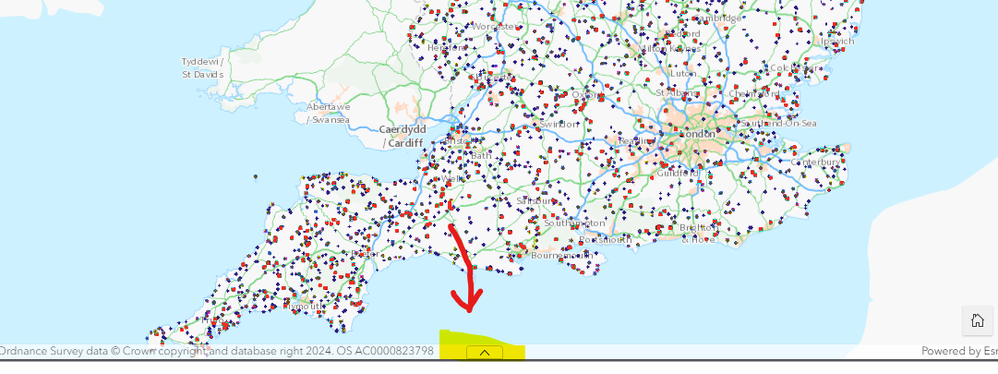

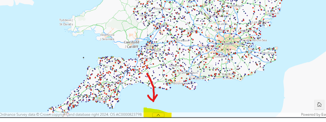

I'm making a simple web app on Experience Builder and don't need this section at the bottom where a table was added in the template that I chose. I've deleted the table and thought that would also get rid of the pop up button too but it hasn't (pics attached). I can't see anywhere else to do it in the Experience Builder app so thought I would see on here if anyone knows of a way I can get rid of it?
Not sure if it's due to the template I chose.

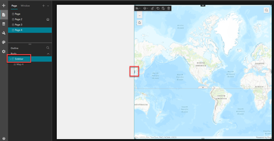

Looks like the attribute table and map were in a Sidebar. You will need to move your map (and any other widgets you might have) out of the Sidebar, so that you can delete it without deleting your map.
In the Outline, click on the Sidebar to select it. Resize it, so you have some space to drop your map.
Now click on your map and drag it over so it is no longer in the Sidebar.
Delete the Sidebar.
