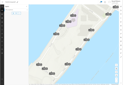

I tested this out with halo and checked our backlog and we have plans to support this for text symbols next release. I checked previous JS Maps SDK versions and the halo was not coming through other releases so it looks like not a regression from the recent update. As a work around if you are formatting your text symbol in Pro through the properties panel instead of the symbol tab halo.
Then I was able to create a text symbol matching your image
https://jsapi.maps.arcgis.com/apps/mapviewer/index.html?webmap=1fa52234ffe6497f9879028e0466d75a

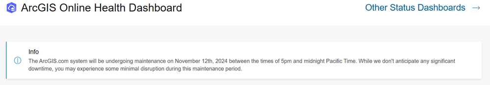

Hi @KatieStenson1  I have the same problem with ArcGIS Online today.  Υou are not doing anything wrong in the procedure, there is simply a more general issue Στιγμιότυπο οθόνης 2024-11-13 164841.png

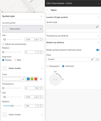

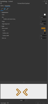

I'm having the same problem, but with an arrow symbol. The symbology worked perfectly in AGOL since 2022, and within the last few weeks I noticed that the halo no longer appears. Was there a change in how halos are supported? @ShaneONeill_144 @RussRoberts  I have tried republishing the service, with no success. When I pull the service back into Pro, the halo appears as expected.
