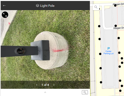

Hi,
This morning I tried out the Attachment Viewer web app and noticed that photos within the same feature layer and displayed in other web apps (Basic Viewer and Time Aware web app) which show the correct orientation are shown upside down in the attachment viewer app. Why would this be? I can look at the photo attachment in the AGOL web map and it looks great (right direction), but when I click on the same feature in the Attachment Viewer the photo is upside down.
Is there a way to rotate the individual images how they are viewed in the Attachment Viewer? Because the photos view correctly in the other apps I don't want to rotate the .jpg attachment itself?

I'm experiencing the same problem when survey responses from Survey123 come in they are all oriented correctly and also are oriented correctly in the  Survy123 Website and Pop-ups, this issue only occurs in the Attachment Viewer App. Do you have an idea when this will be addressed? I'm ready to GO-LIVE with a field survey.
It appears that this is only occurring in the Chrome browser. The Photo is oriented correctly in Microsoft Edge.Screen capture of Attachment Viewer using Chrome BrowserScreen capture of Attachment Viewer using Edge Browser
