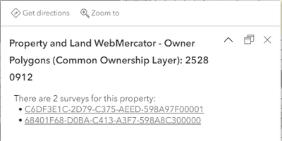

Your return contains just two properties, type and text. The text property will contain the values and HTML code. The blog shows an example of how you can put that directly into the text property. You can also use a variable. For example, here's one I did recently
var related = FeatureSetByRelationshipName($feature, "DCGIS.SURDOCS");
var relatedCount = count(related);
var output;
if (relatedCount == 0) {
  output = `<p>There are no surveys for this property.<\p>`;
} else if (relatedCount == 1) {
  var rec = First(related);
  output = `There is 1 survey for this property:
    <br>&nbsp •  <a href="${rec.FILENETLINK}">${rec.DOCGUID}</a>`;
} else {
  output = `There are ${relatedCount} surveys for this property:`;
  for (var rec in related) {
    output += `<br>&nbsp •  <a href="${rec.FILENETLINK}">${rec.DOCGUID}</a>`;
return {
	type : 'text',
	text : output
which produced this popup, containing clickable links
