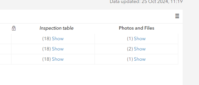

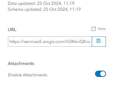

I have a hosted feature layer that I enabled attachments for. I can do this and add attachments - but after doing this I can't see any option to show them in the pop up? Is this a bug or am I doing something wrong?
As you can see from the images below, I have enabled attachments and the features have attachments (jpg's) , but the option to then display them in popups doesn't show?

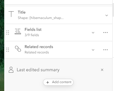

If you click add content, do you get the option to show attachments?
Pop ups led you add content sections such as Text, Fields or Attachments. Your screenshot shows the default settings of fields and related records. You need to add another content pane (or show us that the content options does not include attachments).

You're right - no idea how I missed that! Thanks
