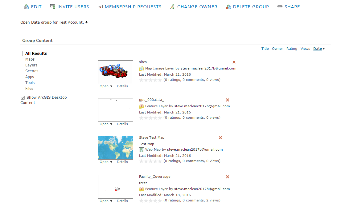

3. I have published a feature layer and shared it with the Open Data group created in the previous step.

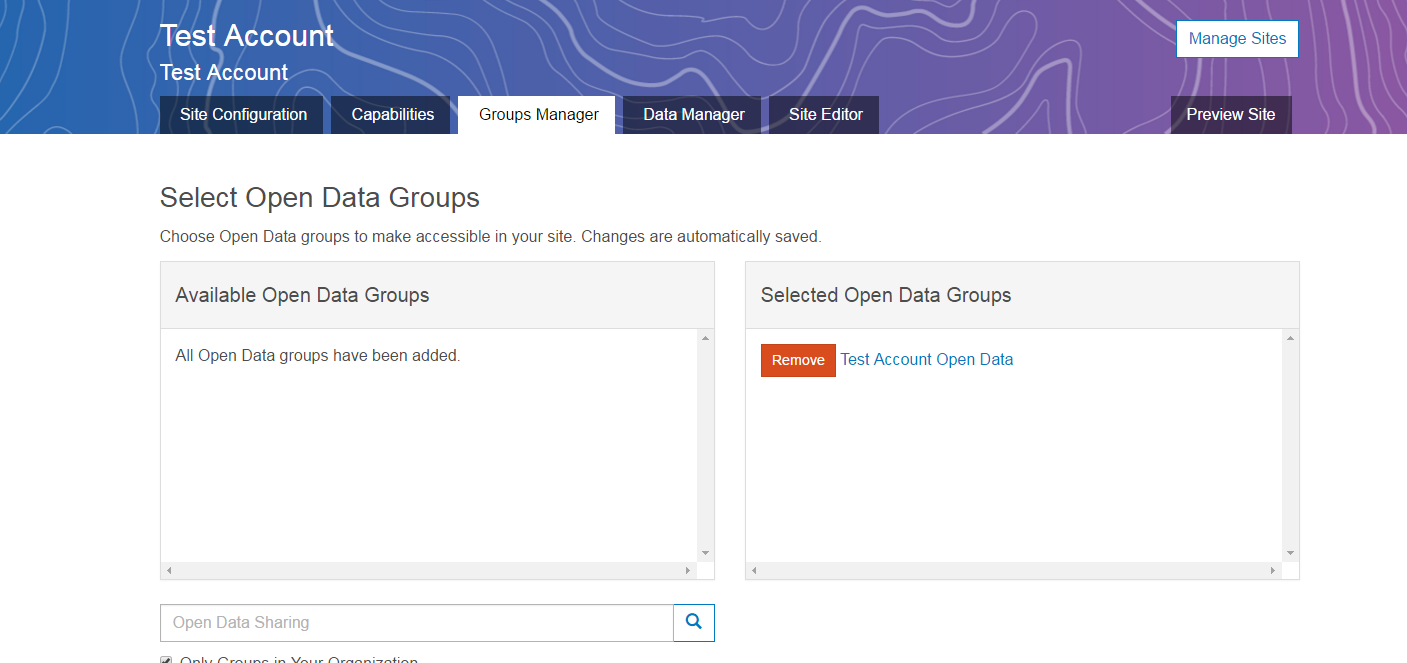

6.  I select Groups Manager and add the Data Group.

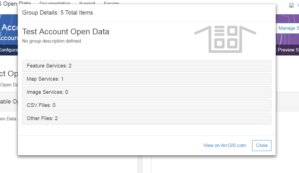

7. I then select group to determine the dataset that are in it.

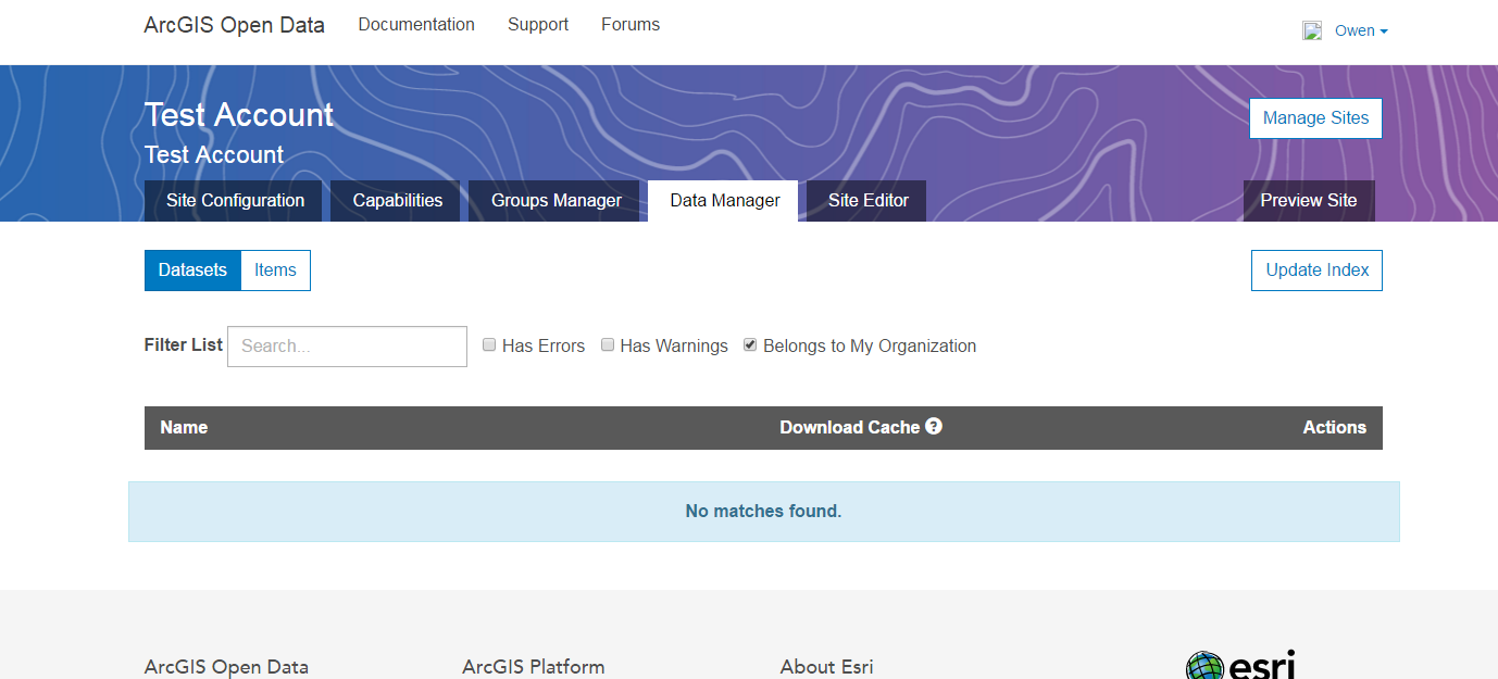

8.  I then go to the Data Manager tab to see the datasets that i have added to the group.  I am expecting to see a list of data.  However, I am not. This is what I see.
Am I doing something wrong?  Is this a limitation of the trial account I have created?

Are all the items that you are including shared as "public"?  I've found that even if shared with a group that is public and available to opendata, items that are not shared as public will not show.  Test one of the items as public and see if that makes a difference.
SteveMacLean1
Deactivated User
Thanks.  That was the trick!
