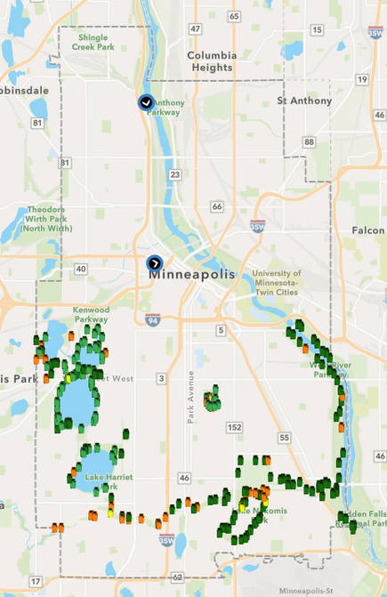

I have several different dashboards with different hosted feature layers. Often, when the dashboard is opened, only half of the map/layer loads. Anybody have any idea why this is?
Here is an example:

@RussRoberts This layer is just a hosted feature layer in AGOL. I have shared the layer and webmap with you.
@RussRoberts I thought I should add, that these issues seems to be always when these layers are within a dashboard map...

Just to add I have seen similar behaviour before in a few cases. In these, it tends to be specific to a certain projection system and geometrically complex data.
I find redoing the Spatial Index or optimising the Layer drawing tends to resolve these and so that might assist in this issue.

@David_McRitchie @RussRoberts David, thank you so much!! I have gone and done what you had mentioned and it seemed to fix the issue.
@David_McRitchie @RussRoberts After rebuilding indexes and optimizing the layer drawing and solving the issue by reloading the dashboard, the issue is already back. The features on the upper half of the map don't draw when dashboard is opened up, again:
