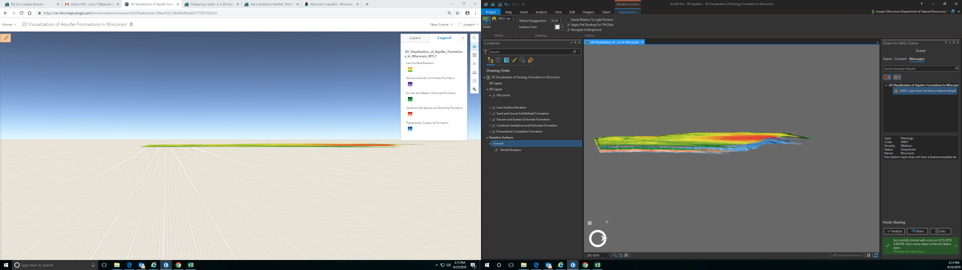

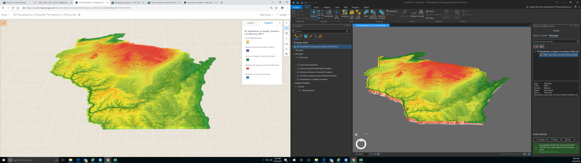

I have Created a 3D view of Geology in Wisconsin to use my ARCGIS-Online account.  When I Shared my Scene from ArcPro (V. 2.3.3) to ARCGIS-online it did not share anything close to what I create in ArcPro.  None of the 3D visualization was shared and it also stacked all my .tiff files on top and I can't even see them!  If anyone could please advise me on a solution it would be greatly apprenticed.  Thanks
As you can see from the ArcPro View the layers are stacked and show vertical exaggeration and the Online Scene does even come close to representing what I created in ARCpro.  If anyone could please advise me on a solution it would be greatly apprenticed.  Thanks

It looks like we are running into a known limitation with Web Scenes - the Web Scene spec can only display offset with 3D elements and 2D elements will always be displayed on the ground. Just to be sure I tested this and am seeing the exact same behavior on my end.

I also found the same issue. My workaround, although not ideal, was to rebuild in ArcScene and use the "Export to 3D Web Scene" tool to produce a .3ws file. Then log into AGOL and "Add the Item" (.3ws) under your My Content. The .tif surfaces then rendered at the correct z in the web viewer.

Looks like you have a tiff that you'd like to display on an exaggerated elevation layer?  The Scene Viewer doesn't directly support vertical exaggeration like Pro does, but you can create and publish your own exaggerated elevation layer.
Using a Raster calculation on a DEM, you can multiply the values by the exaggeration factor and then publish this as an elevation layer that you can bring into the Scene Viewer.  Share a web elevation layer—ArcGIS Pro | ArcGIS Desktop.  I have a 10x elevation service shared publicly that you can see how it looks-  search for bathyx10.
