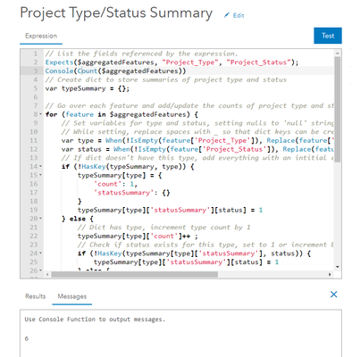

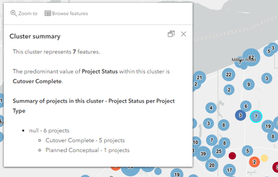

I am clustering points in a web map and I have an Arcade script that summarizes some of the attribute values from the clustered points.
I am finding some cases where the number of features reported to be in the cluster (and the number of records I get when I click on "Browse Features") matches up with the counts that are being returned by my Arcade script, but other cases where these numbers do not match up.
I thought at first that there might be a problem with the logic of my script, but after reviewing it and adding some Console() statements to the script, I am finding that the "Count($aggregatedFeatures) returns a lower number than what the feature cluster contains.
Example of a cluster where there is a mismatch:
Example of Arcade editor log with Console(Count($aggregatedFeatures)) statement - the layer has been filtered to just the 7 points that are in the cluster from the above screenshot:
The full Arcade script I am attempting to use:

MattChomicky1
I believe I have found the cause of this issue. I added some different Console() statements to the script so that I could compare Count($aggregatedFeatures) to $feature["cluster_count"] as I clicked on clusters, and I found that this warning was showing up in DevTools when I clicked on a cluster for which there were discrepancies between the two counts:
It seems that the issue was happening when points in the cluster had values for one of the fields that were not included in the domain for that field. I added the new value to the domain, and am now seeing the result that I was expecting returning from the Arcade expression.
