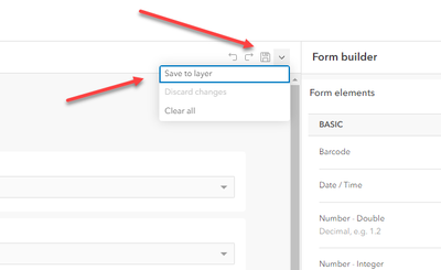

Now that we have the ability to save the form info into the layer OR the map, is it possible that the Form info was saved to the layer itself?
Possibly has a calculated visibility expression on that field or something (which, by default will Null out any values in there when 'hidden')?
Can use ArcGIS online Assistant to inspect the JSON of that layer and see if any expressions are in there.
