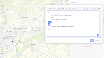

Hi,
There is an easy way to remove the spacing. Go to the HTML section in the text pop up. Remove for example the highlighted area as you can see below and add <br> between the parts. Now the spacing is removed.
Hope this will help 🙂

Exactly what I needed, thank you!
