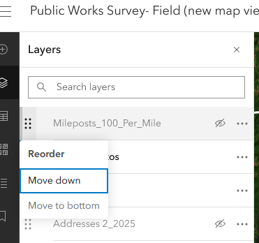

In the new map viewer in AGOL I used to be able to drag and drop layers in the interface to reorder them.
This morning it isn't working and I have to click on each layer and click Move up or Down.
I am working in Arcgis Online, using Firefox. The move icon with the 4 arrows shows up but the layers won't move by dragging.
Is this "by design"?
